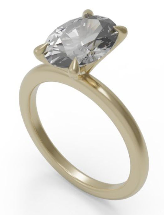

Hi! So I’m wondering how to import KeyShotXR presentations correctly. Metal options come out ok but gemstones are all milky and clear instead of refractive in the 3D option of the presentations. How can this be fixed?

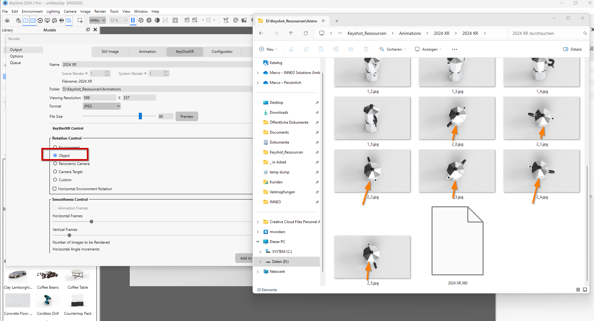

Especially if you have the environment rotate together with the object it makes sense there will be certain angles which will look dull. It’s better you have a stationary environment and only rotate the object in KeyShotXR since most studio environments are made for a certain camera position.

Changing the rotation control to object, would help to get a consistant lighting.

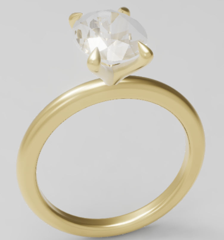

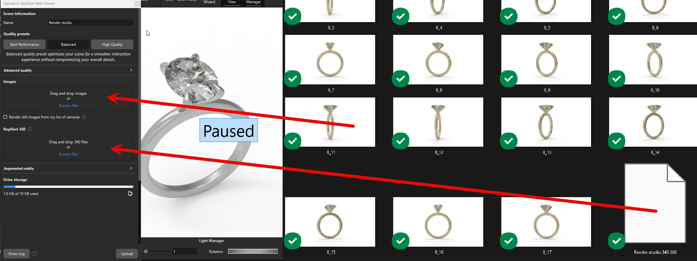

I upload the renderings to KeyShot Web Viewer and the 360 file and they turn out great! I make sure my camera, lighting are good to go as well as my material variations for the presentation mode all set up. Everything looks good in KeyShot until I upload it and it creates my web viewer page. It’s the 3D viewer that creates this non reflective milky appearance to all the stones.
https://webviewer.keyshot.com/go/YLFXhBA
Ah yeah that’s an issue with every real time 3D viewer I know. It’s not really different in for example the viewer Sketchfab uses f.e: Sketchfab
The problem is that such calculations can’t really be done real time. At least, they might if you’ve a really powerful 4090 and the viewer actually uses the ray tracing capabilities of it.
That’s not how online viewers work compare it to game graphics, it works the same in games which don’t have raytracing support. Basically you get high glossy transparent grey with reflection. Since reflection is possible it can help to have a very contrast rich striped environment for example. That still won’t so any actual refraction of the light but it will make the facets of the diamond appear more obvious.
So it’s more like a general limitation of real time 3D viewers. Not sure if you worked with something with Substance Painter or MarmoSet but they are all very limited if it’s about glass looking like real glass. Same with the Unreal Engine although it has a quite quick path tracing which on decent hardware could reach real-time if the scene is not too complicated I think.
Your local XR output are renderings done with all the possibilities of KeyShot’s engine. But the webviewer use GLBs. This format is very limited, e.g. no refraction index.
You can use the webviewer to showcase different metals in various lightings. And use the option to upload the XR renderings. Then you get the best of both ways.
As image, I would upload some stills / detailed shots of some variation or present a collection of different metal / gem variation, perhaps with other lighting or post work.
